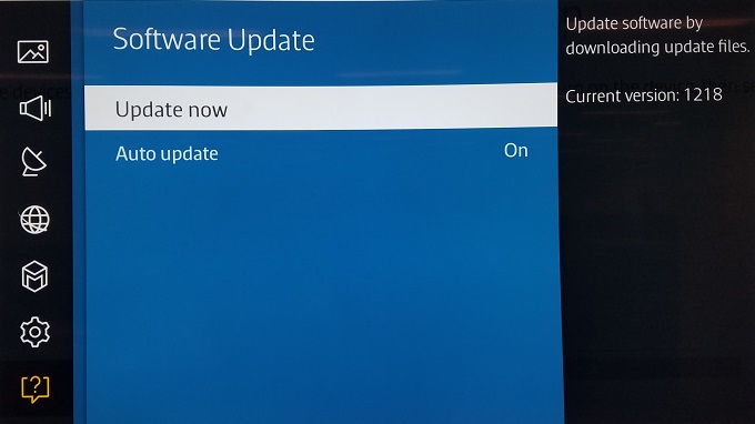

will i be prompted to update samsung tv ? or will it auto update ? if so how do i turn off auto update ? ive turned off auto updates in apps. mines works i think its a 2017 model

Jul 29, 2018
24
thanks Harry, auto update turned off now, many thanks for your help .
Turn off autoupdate,
Or if you have no option my strong advice is to use Fork Player.
Best Regards,
Harry
